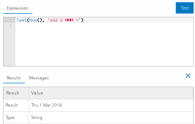

XanderBakker
Esri Esteemed Contributor
It also doesn't seem to be an issue in ArcGIS Online:
