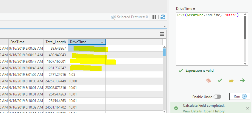

Thanks Xander. This works, but only for times over one minute (see screenshot).
LeviCecil
I used this Text(EndTime, 'mm:ss')

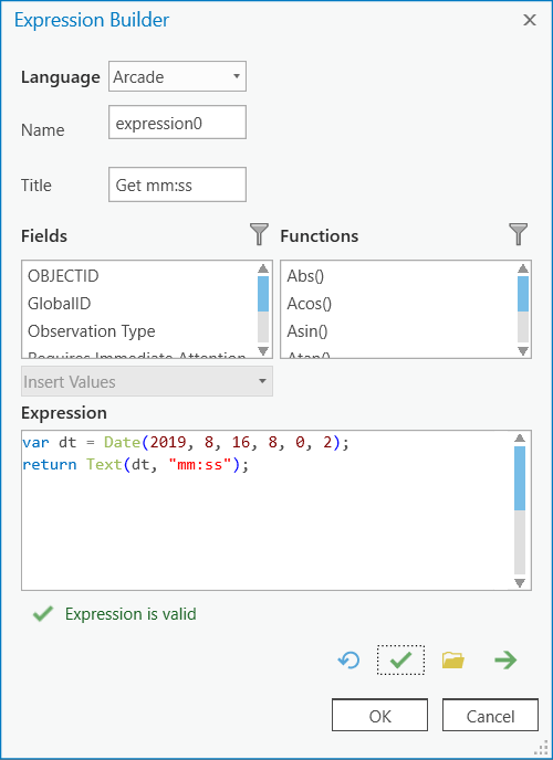

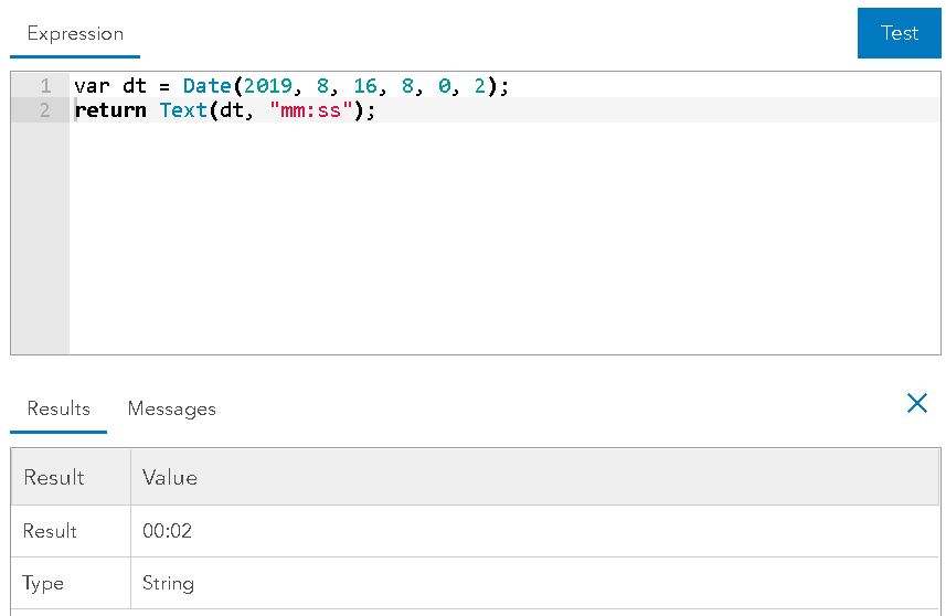

I tested this in the playground here: ArcGIS Arcade | ArcGIS for Developers  and it works there if I define a date as the one you have:

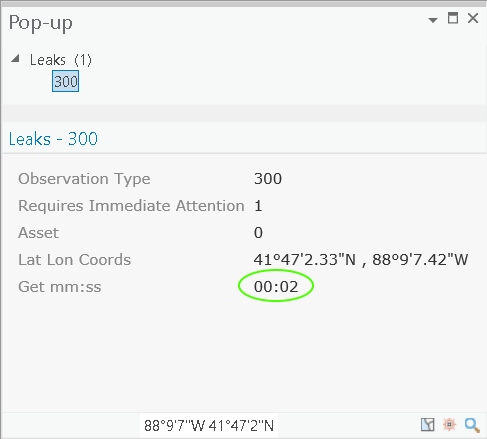

When I do the same in ArcGIS Pro:
It also seems to work:
Not sure what is going wrong in your case...

I added the extra 'm' to your original solution Text(EndTime, 'mm:ss'). A single 'm', Text(EndTime, 'm:ss') results in an empty string if the time is less than a minute.
