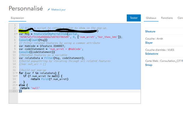

KARIMLABIDI
Hello Everybody,
I have the same problem than DonMorrison1 but I can't solved it. I got the same error msg.
I tried the little code of Dan but it doesn't work .
Any idea?
Thanks a lot
JohannesLindner
MVP Alum
Your "build out popup" code is wrong.
If you only want to return the first entry of relateData:
var firstRelateData = First(relateData)
if(firstRelateData == null) {  // no related data
  return "null"
return firstRelateData.num_arret
If you want to return all related features:
if(Count(relateData) == 0) {  // no related data
  return "null"
var all_num_arrets  = []
for(var f in relateData) {
  if(f.num_arret != null) {
    Push(all_num_arrets, f.num_arret)
return Concatenate(all_num_arrets, ", ")
Have a great day!
Johannes

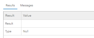

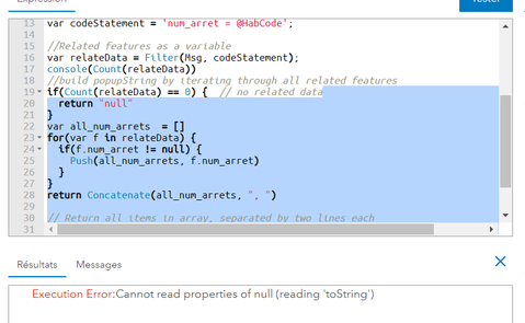

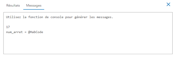

KARIMLABIDI
Thank you Johannes but I Got the same problem. I can't count the relateData with the filter, the problem is in.
I don't understand this error msg because I have data in each row of my table.
JohannesLindner
MVP Alum
Hmmm. Try adding this at the start of your script:
if(IsEmpty($feature.IDARRET)) {
  return "null"
Have a great day!
Johannes
KARIMLABIDI
yes it works. Thank you!!

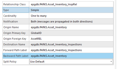

Hello, I'm getting an issue trying to run this procedure but I can't quite figure out what's wrong. Here's my code:
var assets = FeatureSetByRelationshipName($feature, 'epgdb.PARKS.Asset_Inventory', ['*'], true)
console(assets)
console(count(assets))
console(typeof(assets))
// Get the first park asset (should only be one)
var asset = First(assets)
Expects(assets, 'AssetType')
// If there was an asset, return the AssetType of it,
// Otherwise, return null
if (!IsEmpty(asset)) {
    return asset['AssetType']
} else {
    return null
 I have park assets, with a related inspection table. The table is where I'm placing this code, and the relationship name in the featureSetByRelationshipName function is the backward path label from my EGDB relationship class (is that correct?)

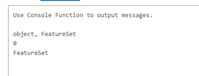

I've tried adjusting a lot of the parameters but the closest I get is always returning null:
The console messages indicate 0 assets, which I guess makes sense considering this is just in the expression builder and probably doesn't know what the related table would be targetting?
The problem is that when I open Field Maps and try to create a related record, the field I add the calculation to just gives me the error: "Failed to calculate"
