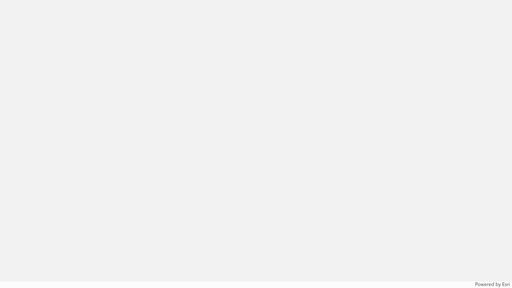

And it's got the information about using api keys.  I built an api key for my test app (using vite) and after I setup the information to allow use of my enterprise portal (which is on version 11.4) and using 4.33 api, it's still prompting me for a login, even though I've selected the items in the webmap that I'm using the key to authenticate for.  Here's my current page code (remember this is to test api key authentication):

I'm actually NOT seeing the token get passed, neither in the url as a query string parameter or in the request headers as a token.  What am I missing?

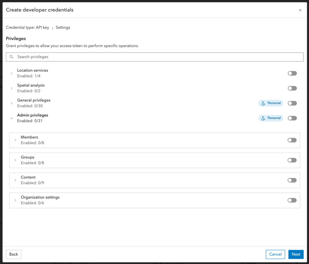

Yeah it's still prompting me for credentials. Now, when I build my api keys credentials through the enterprise portal, I get to the privileges page and I leave that with nothing selected.  I hit next and go to the items selection and select the webmap (and participating layers) that I'm trying to access.  Is there a disconnect maybe that way? Here's the privileges page (I'm building the credential with the portal admin account):
Mine looks nothing like what is in the docs.
Noah-Sager

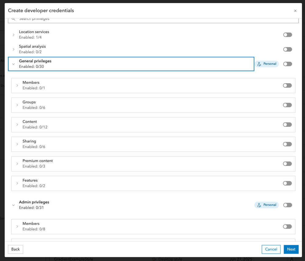

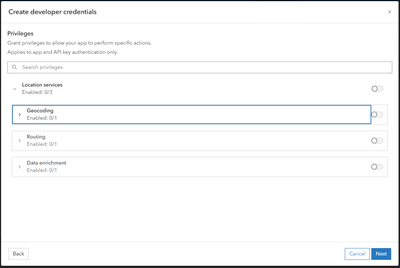

@DeanWilson - yeah, that doesn't look right to me. I use AGO, not Enterprise, but this is what it looks like for me.

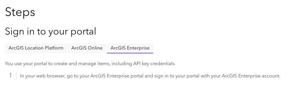

Try this tutorial and make sure you select the ArcGIS Enterprise workflow on the right. Also ensure you have the correct user roles and permissions.
https://developers.arcgis.com/documentation/security-and-authentication/api-key-authentication/tutor...

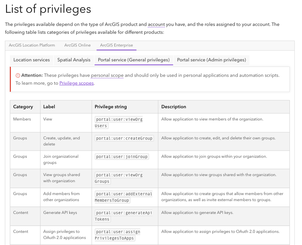

Lastly, check out the doc for privileges and roles:
https://developers.arcgis.com/documentation/security-and-authentication/reference/privileges/#list-o...
