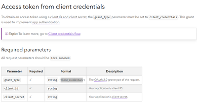

https://developers.arcgis.com/documentation/security-and-authentication/reference/rest-authenticatio...

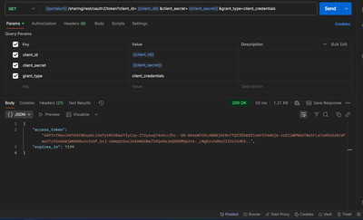

HildermesJosMedeirosFilho_0-1759839137269.pngHildermesJosMedeirosFilho_1-1759839159979.png

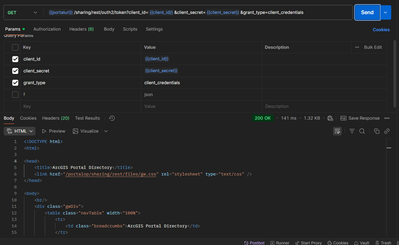

I would double check if you mispelled something in the code, if you did you get 200, but a page...in html

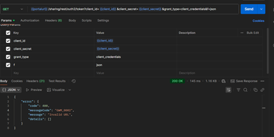

You can pass format json to get the proper error code.
If I`m not mistaken the api is jsonp compliant unless turned off
