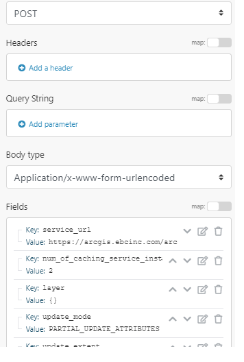

Hi @JustinReynolds , thanks for your feedback. In my situation, I also confirm that via the web interface of the rest api (.../arcgis/rest/services/System/SceneCachingControllers/GPServer/Manage%20Scene%20Cache/submitJob) everything works well. However, when I try to submit this job via an external app (Integromat for example), the job is nicely created and lauched but quite quickly it fails, indicating an error (esriJobMessageTypeError: ERROR 001812: Unable to connect to the database used for scene caches (In-server connection failed. Server is federated but server environment doesn't have token or referer.)".
Can you please provide the way you triggered it via the rest api ? On my side, I used a POST method, with url-encoded fields :
Also, when you say that you submit the job via python, did you launch your python script directly from the arcgis server machine (assuming that you're on a arcgis entreprise deployment) ?

DallasShearer225
Pierre here are some of the key inputs in the request to rebuild the cache, hope this helps...
_referer_url = "https://{}".format(host)
submit_url = "https://{}/server/rest/services/System/SceneCachingControllers/GPServer/Manage%20Scene%20Cache/submitJob?.format(host)
service_url = '{}/server/rest/services/Hosted/{}/SceneServer'.format(_referer_url,                                                                   service_name)
params = {'service_url': service_url, 'num_of_caching_service_instances': 2, 'layer': {}, 'update_mode': 'RECREATE_ALL_NODES', 'update_extent': 'DEFAULT',
'area_of_interest': {"displayFieldName": "", "geometryType": "esriGeometryPolygon", "spatialReference": {"wkid": 54051, "latestWkid": 54051}, "fields": [{"name": "OID", "type": "esriFieldTypeOID", "alias": "OID"}, {"name": "updateGeom_Length", "type": "esriFieldTypeDouble","alias": "updateGeom_Length"}, {"name": "updateGeom_Area", "type": "esriFieldTypeDouble", "alias": "updateGeom_Area"}], "features": [], "exceededTransferLimit": False}, 'f': 'json', 'token': self.token}
headers = {"Referer": self._referer_url}
request = urllib.request.Request(submit_url, data=self._encode_data(params), headers=headers)
with contextlib.closing(urllib.request.urlopen(request)) as response:
    content = response.read()
    content_decoded = content.decode("utf-8")
    result = json.loads(content_decoded)
    print(result)
JustinReynolds
@PierreMarcombe  @vipapril See the comment from Dallas above.
