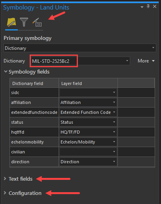

  1. Right-click the Land Units layer in the Contents pane and select Symbology to begin configuring the symbology:
    1. Primary Symbology: Dictionary
    2. Dictionary: MIL-STD-2525Bc2
  2. Map symbol fields and text fields to the dictionary. In this exercise, the fields are mapped automatically.
  3. Accept all remaining default configuration properties.

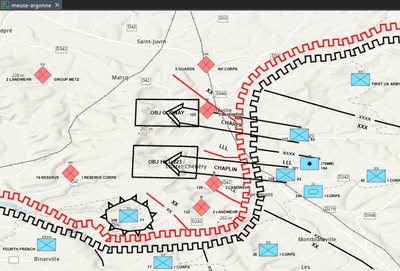

Repeat the above steps for the Control Measure - Lines and Control Measure - Areas layers. Your map should look like the map below:

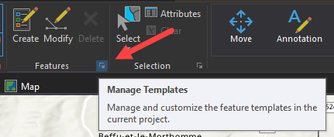

After symbolizing your data with military symbols, you may want to create Feature Templates to define categories of items that editors are allowed to add to a feature layer, based on specific combinations of attributes.
  • Navigate Edit > Features > Manage Templates to open the Manage Templates pane.

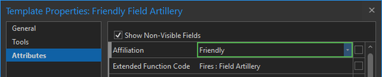

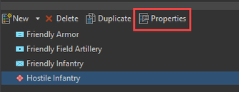

  • Follow the instructions here to create feature templates for some of the layers. I elected to create feature templates for a few attribute combinations in the Land Units layer:
  • To configure the feature templates you have created, select the template you want to modify then “Properties.” In the Attributes tab, you can select attributes values in the applicable fields to override the default geodatabase values and apply them to features the template creates:

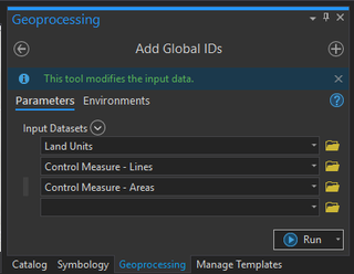

  • Add Global IDs to the Land UnitsControl Measure - Lines, and Control Measure - Areas layers.

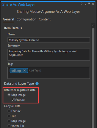

Share the layers in your map as a web layer to your Enterprise Portal with the following configuration:
  1. Choose Map Image and check Feature to enable feature access. This is important so that the web application will be able to properly display the military symbols and allow them to be edited.

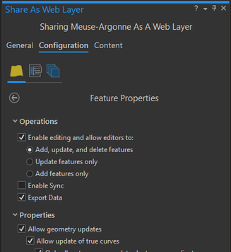

  2. Configuration > Feature:
    1. Operations: Enable Editing on the feature layer (check the appropriate option such as Add, update, delete) and optionally choose Export Data or Export Sync.
    2. Properties: Check all boxes (curves, z and m values) as appropriate.

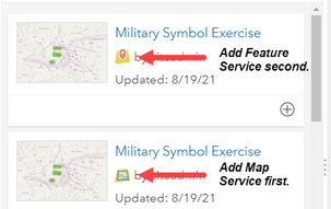

  2. Add the map service to the web map first, then the feature service and the two services will appear as one layer in the map.
    2. Note: After adding the layers to the web map, you should see the Edit button in Map Viewer Classic. If you don’t see the ‘Edit,’ return to Step 2 of Sharing the Data and ensure that editing is enabled on the feature service.

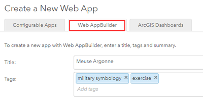

  3. Save the web map and create a Web App in Web AppBuilder:
    1. After saving the map, click Share > Create a Web App > select the Web AppBuilder tab Get Started after specifying a title and tags for your web app:
    2. At this point, Web AppBuilder will open in your browser tab.

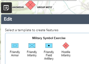

    1. If you created feature templates for your layer in ArcGIS Pro, the templates you created will appear in the Edit widget:
    2. If you did not, default symbols will appear in the widget instead, but you will still be able to add and modify features with military symbols.
