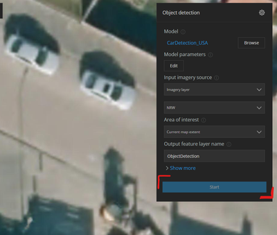

Everything works fine, except the inferencing. When loading a model in the inferencing app, the Start button is supposed to turn active, but it does not:
I don't have a dedicated GPU, but I set the mode to CPU in the settings of the widget above.
Do I miss something? I tried to use the Esri sample deep learning packages and restarted the servers, but no success.

The issue with the Button is a known bug and can be resolved by choosing another Input imagery source (and revert back to the original). This will activate the button.

Hi Simon -
It sounds like a bug that we already fixed (that didnt make its way into the 11 release). If its the same bug, after selecting the model, re-select the imagery layer from the dropdown list should enable the start button. connect with us if you still run into the issue.
