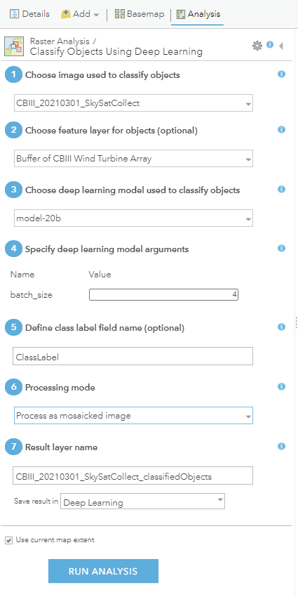

I have created *.dlpk and published to the enterprise portal using the ArcGIS Python API. We have installed Deep Learning Library to Raster Analytics Server and from our Portal, I launched  Classify Objects Using Deep Learning. I executed the inference after I selected the published model and filled parameters. It displayed the process icon for a while and failed with a simple Failed message.
I looked at the log in the Raster Analytics and it shows some error messages as below:
  • SEVERE: Error executing tool. ClassifyObjectsUsingDeepLearning Job ID: jbde8f26feb0048a28792dd42e225b746 : OutputCatalogPath failed. Error: <built-in method GetOutputCatalogPath of HostedGP object object at 0x0000029B60BDC060> returned NULL without setting an error ClassifyObjectsUsingDeepLearning failed. Failed to execute (ClassifyObjectsUsingDeepLearning).
  • WARNING: ClientCachingAllowed property not found.
  • WARNING: IgnoreCache property not found.
I have tested the model in my local server from Pro and it works. Does anyone know what is going on?
