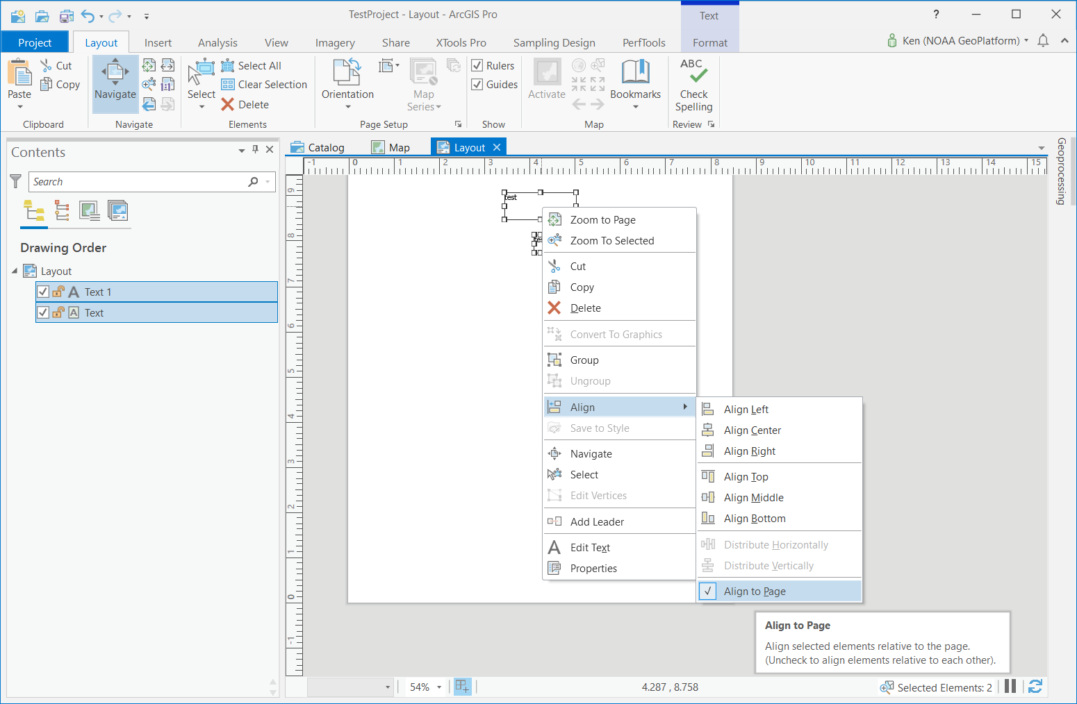

I select 2 objects to align center to each other, but they align to the map frame and so end up aligned to the center of the map fame. Why?

Do you have the "Align to Page" option checked?
