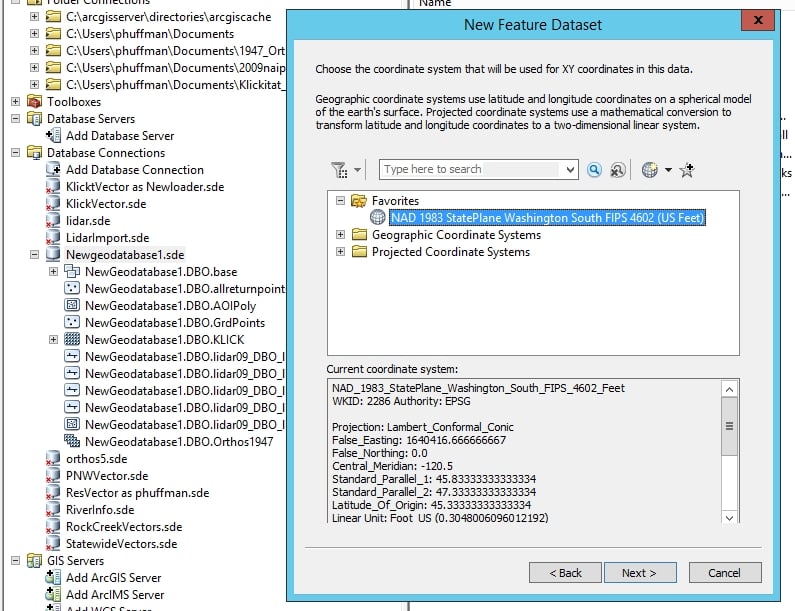

I am trying to create some new feature datasets for lidar terrains in an SQL enterprise geodatabase in ArcCatalog 10.3.1.  However, when I right click in 10.3.1 ArcCatalog or ArcMap Catalog Window > New > Feature Dataset, after naming the new feature dataset, the next window wants me to define the xy coordinate system.  In my experience, and in the 10.3.1 and 10.2.2 help files, there is supposed to be an Import button on this window that allows me to get the coordinate system from an existing feature class. (as in the link above to another thread)  I don't understand why it seems to be missing in both Desktop 10.3.1 for enterprise geodatabases and with Desktop 10.2.2  using file geodatabases. (see image below)  Is there an option in Desktop that I need to set?

But what happened to my import button?
KyleBalke__GISP
Drop down next to the silver globe
KyleBalke__GISP
PaulHuffman
Thanks, that was easy.  I thought I was losing it.  I remember the import button looking like the image at the end of this thread.  https://community.esri.com/message/77856#77856   Also, 10.2.2 Help doesn't mention a pulldown, it just says  "Alternatively, click Import and navigate to the feature class or feature dataset that uses the spatial reference you want to use as a template. "
