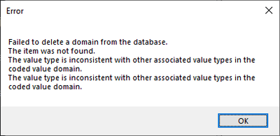

I'm having trouble deleting a domain list from my file geodatabase.  When I try to delete to domain I get an error that says:
"Failed to a delete domain from the database.
The domain was not found.
The domain was not found. [name of domain]"
I also cannot add any new entries to the domain or change the domain name and description; I get a similar error that says:
"Failed to update a domain.
The domain was not found."
