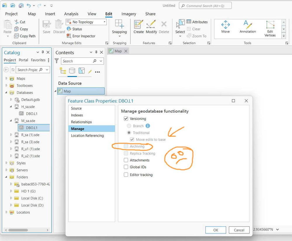

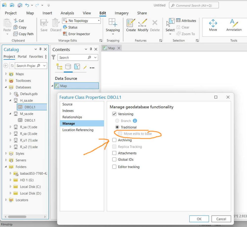

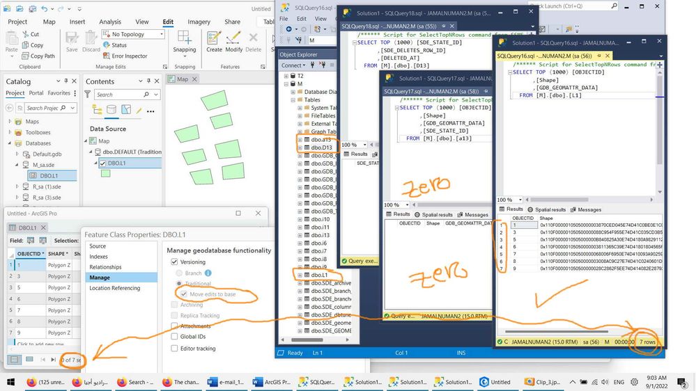

But what are the pros and cons for versioned feature classes with and without “move edits to base” option?
Is it accurate to say:
  • Versioned feature classes with “move edits to base” option are more performant but have less functionalities (for example, archiving is not possible here)
  • Versioned feature classes without “move edits to base” option are less performant but have better functionalities (for example, archiving is possible here)
