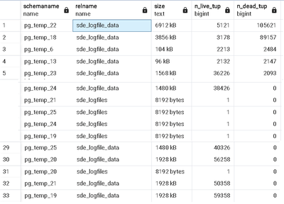

yockee
If I do TRUNCATE on both tables, do I have to stop the map/feature service first ? Which one should be truncated first ? I have similar issues where the table is in production.
If I have so many log tables, should I truncate all of them ?
George_Thompson
Esri Notable Contributor
It looks like those tables / files are used by users on the Enterprise Geodatabase. I am not sure I would truncate those table, unless all connections are not active and closed.
--- George T.
