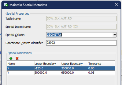

  2. Yes, I believe so. Screenshot above has it in two dimensions and the extent is reasonable.

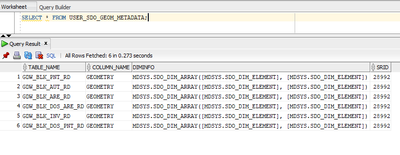

  3. Yes, the metadata is populated. There was a screenshot attached but please also see below;

Thanks so much for the insight!  Indeed I think this is almost entirely down to the 10.6.1 geodatabase unfortunately. This happens with a number of tables and views and doesn't seem to be tied to any one specific one. Everything else worked out ok, no null geometries, and apart from one erroneous geometry in one of the views the rest are all OK. Metadata also complete.
