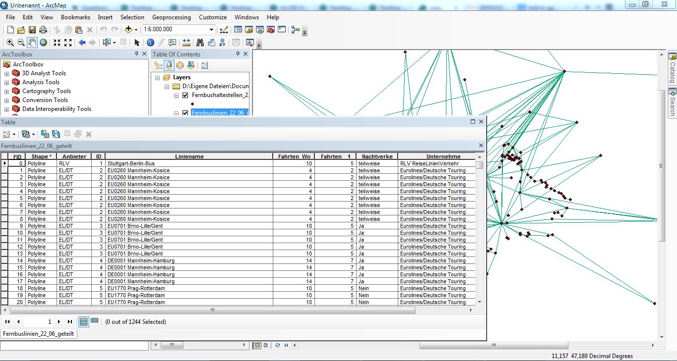

I guess your idea doesn´t work, because the table doesn´t include any start- an endpoint information. This information is only included in the shapefile, but not shown in the table. In my opinion it´s not possible to work with the data in the table. Thats why I guessed it´s neccessary to work with the spatial data.ot:
To the screenshot:
"Fahrten_Wo" is the number of times per week. All other columms are not used. I already splitted up the entire buslines to lines between single cities. Thats why you see the line "EU 2060 Mannheim-Kosice" 8 times: its sepated by the intermediate stops (Mannheim-Stuttgart (FID 1), Stuttgart-München (FID 2), and so on). But this names of the intermediate stops are not in the table

The table and the shapefile aren´t different. What I just wanted to say is, that there aren´t any position data (like koordinates or citynames) in the table. That´s why I thought your idea can´t work.

The field called "Linienname" ist just the name of the WHOLE line. It consist oft the linename/number itseslf and the very first city and the very last city. Thats why I can´t use this field: I want to know the sum of all runs a week (sum of several companies) between two cities in Germany. Would I just use the cities named in the field "Linienname" I would ignore the connections between the intermediate stops of the lines.
