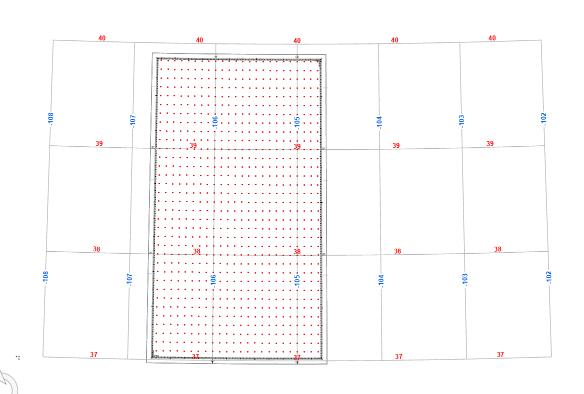

Let me know if you are able to see it or not but here is the picture of what I am talking about...
Here is the Exampe of the Forest Reserve Maps

Phew... I have been working very hard and tired and got  what I wanted...so here is the picture..
I still have not georeferenc the old picture yet....so the begins now !
