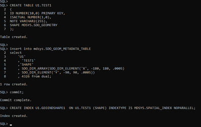

The table created with the ddl for example. The table not visible in ArcCatalog
CREATE TABLE U1.TEST1
	ID NUMBER(10,0) PRIMARY KEY,
	ISACTUAL NUMBER(1,0),
	NOTE VARCHAR2(255),
	SHAPE MDSYS.SDO_GEOMETRY
insert into mdsys.SDO_GEOM_METADATA_TABLE
select
    'U1'
    , 'TEST1'
    ,'SHAPE'
    , SDO_DIM_ARRAY(SDO_DIM_ELEMENT('X', -180, 180, .0005)
    , SDO_DIM_ELEMENT('Y', -90, 90, .0005))
    , 4326 from dual;
commit;
CREATE INDEX U1.GEOINDSHAPE1  ON U1.TEST1 (SHAPE) INDEXTYPE IS MDSYS.SPATIAL_INDEX NOPARALLEL;

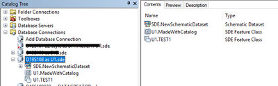

ChrisUnderwood
Hello @vsevgu
In my Oracle 19c/Geodatabase 10.8 I created your "U1" user using 10.8 ArcCatalog's Create Database User tool. I then ran your DDL using SQLPlus and your data was then listed in ArcCatalog as you wanted. So in order to do this please update your system to the current versions.
Note, although your data is listed it is not Registered with the Geodatabase.
