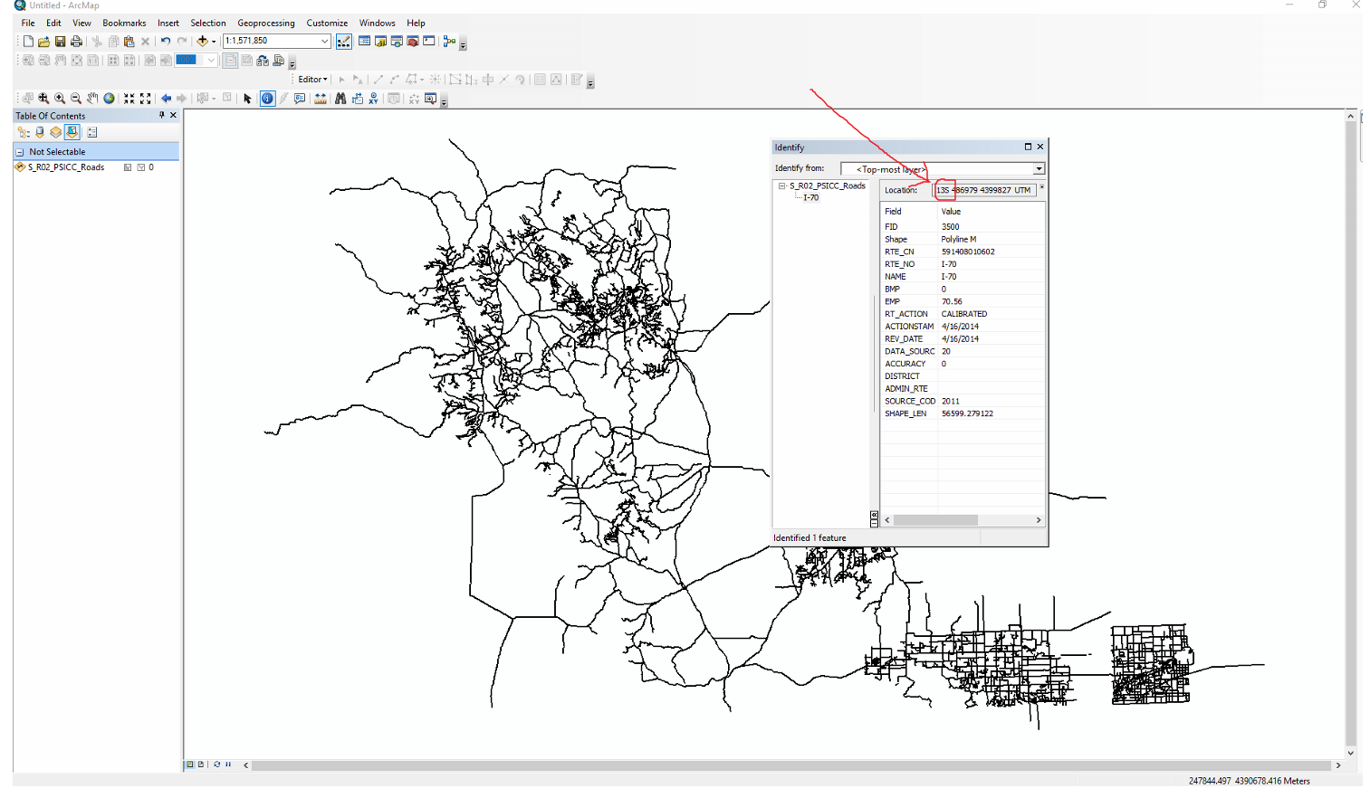

I just discovered thht my Location in the Identify dialog box  had the wrong UTM. It says it is 13S but I am working on 13N because all of my data are suppose to be in NAD 1983 UTM Zone 13 N.
Why does it show up as 13S instead of 13N ???
How do I fix the problem ?

check the map... that is the true utm system and it allows you to narrow your location down to one 6 degree x 8 degree block of longitude and latitude
You may consider this old school, but the 'current' division of splitting utm zones into the (N)orthern  and (S)outhern hemisphere is 'relatively' new.

Could you attach screenshot for the projection of data frame and another one for the feature class.

You aren't in the southern hemisphere you are in utm zone 13S
https://en.wikipedia.org/wiki/Universal_Transverse_Mercator_coordinate_system#/media/File:Utm-zones....
Don't confuse S with S as in the first S is the utm zone grid designator and the generic S is a simplified variant for N or S

So it is correct that it is as in the  "Grid"  shows 13 S ?
I see.
