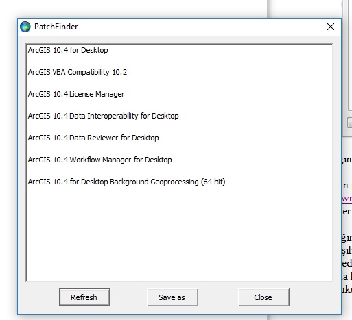

I have too same problem with 10.4  , I had saved something issue . mxd but after I was opened ; I could see only .xls files . Those are my extencion. Help us please
