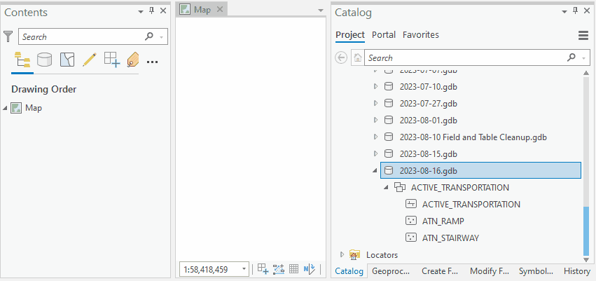

For anyone who's interested, here's a GIF that demonstrates an FC being moved in and out of an FD by dragging and dropping in Catalog (ArcGIS Pro 2.6.8):
