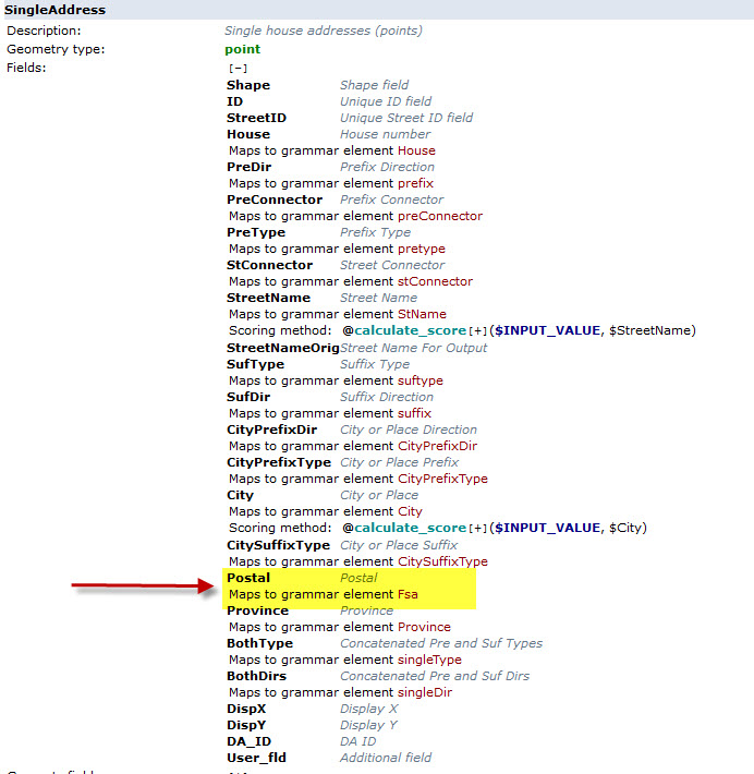

I have a Locator style file to use for building Locator for our organisation.  We need to geocode canadian style adresses.
I have difficulty to understand the style file and I need to do some adjustment to the postal code mapping.
I'm using the "Single house addresses (points)".
If I try to geocode an addresse, the postal code is not used.  For the same city, I have 2 identical addresses except the postal code (this is due to city fusion).  So I need to find the right addresse with the right postal code.  But it's not working.
ANy idea?
The mapping schemas
BruceHarold
Esri Frequent Contributor
Francis, what change do you need to make in the mapping?  If you can supply an address you need to support we might be able to help with the style file.
