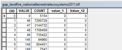

It would probably help if you showed the tables to see what you are trying to do.
If one is a raster table and the other is some other type of table, and they have no matching key field, you will have to produce one
