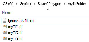

If you want to loop through all the .tif files in a folder or sub folder like this situation:
You could use this:
import os
rootfolder=r'C:\GeoNet\Raster2Polygon'
for root, dirs, files in os.walk(rootfolder):
    for file_name in files:
        name, ext = os.path.splitext(file_name)
        if ext.upper() == ".TIF":
            print os.path.join(root, file_name)
This will yield:
C:\GeoNet\Raster2Polygon\myTifFolder\myTif1.tif
C:\GeoNet\Raster2Polygon\myTifFolder\myTif2.tif
C:\GeoNet\Raster2Polygon\myTifFolder\myTif3.tif
