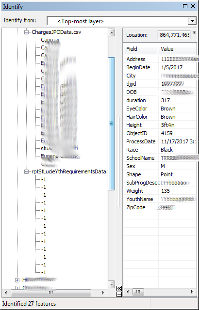

I have several csv files that are updated by an external organization on a nightly basis. The records from one csv file are used to geocode and create a point FC with python in a fGDB. I can add the csv and point FC to ArcMap and create a Relate in the Properties dialog of the feature class to each of the tables. The end users will then use the Identify tool to inspect features in their zones. When the relationships are expanded, they would like to see values from specific fields so if they want to drill down and see the related records, they can see what they want without having to click on every related record. Instead, they see useless information or sometimes, just a "-1".
I have told them about bringing the tables into ArcMap and setting the Display Expression in the table properties. This works in that MXD only. They want to have a .lyr file that they can drag and drop into a new MXD and see the pertinent info. I've tried creating the other tables in the fGDB and creating Relationships there but can not control what is shown in the identify window.

So...
I ensured that the ArrestingOfficerName is just ArrestingOfficer and the first field in the csv is my string field with the data I want to see. I then dragged the csv into arcmap and made the Relate, the display expression is set correctly in the identify window. However, if I create a relate to that same table without bringing it into arcmap, I still get the wrong info in the identify window. I tried exporting the csv table into the fGDB and when I set up the relate without bringing into arcmap, the display expression is the OBJECTID.
So it seems that the behavior described in the link I posted is only true if the FC or table is brought into arcmap. Not if it is referenced externally in the csv or fGDB.
