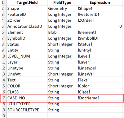

When using an expression to assign a value to a field in the Mapping worksheet, the tool fails to append the shape data.
For example, using the expression below for the CASE_NO field:
TargetField
FieldType
Expression
CASE_NO
String
!DocName!.split(".")[0]

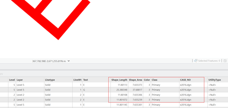

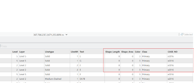

causes the tool to append the attribute values but not the shape. See the below screenshot:
However, if I use only !DocName! (without .split(".")[0]),
the shape data is appended correctly. See the below screenshot:

SumitMishra_016
Hi @MikeMillerGIS ,
Yes, Source and target are both annotation feature class with Same schema.
You can test this by creating any Annotation feature class in ArcGIS 3.4.
It is working in 3.3 but not in 3.4. Also this is only for Annotation feature classes other feature classes are working fine
