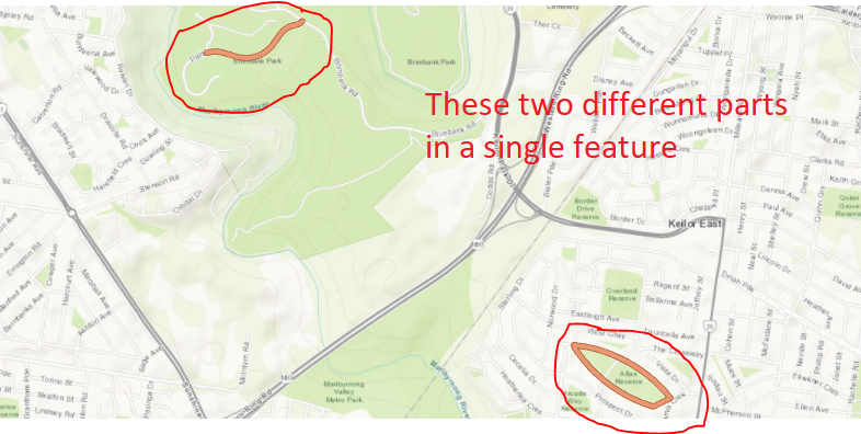

I have been stuck with this problem for well over 2 days, I think it's time to shout for help!, Attached data for reference. The other feature does't visually look like a self closing loop, but it is. The raw data has two features with same ID overlapping each other, which could cause a self closing loop.
What I'm trying to do:
We are looking at migrating to Roads and Highways to manage our Linear road data. We have well defined calibration points for few important roads but no calibration points for local roads. I'm trying to auto create calibration points using Generate Calibration Points tool. It worked fine for a small dataset. When I tried to run it on a larger dataset ArcGIS Pro crashed on me.
I could potentially replace this tool by creating end points and adding length of the feature as calibration points, but apparently this tool handle Loops and Lollipops
Investigation So Far:
I dug deeper and isolated two offending features which were causing ArcGIS Pro  to crash. I deleted these two features and ran the tool again it worked fine. When I ran it for 2 isolated features ArcGIS Pro crashed again. Both these features have one thing in common, they are multi-part feature and one of the part is a self closing loop
Multi-part loop

For the two features you provide, the following can help identify them:
1. Run Feature To Polygon tool on the input Lines (roads). Say the output is tmpPolys.
2. If tmpPolygs contains polygons, run Near tool on the Lines and Near Features should be tmpPolys; set search distance to be 0 or very small. The Lines with loops (singlepart or in multipart) will have polygon IDs in Near_FID field.
However, if your roads have multiple features that may form polygons (closed road block), then the above won't work. You can try the following:
1. Run Feature Vertices To Points with BOTH_ENDS option on roads data. Say output is bothEnds. For your sample data, you get 8 points - each part of the features gets two endpoints.
2. Run Find Identical on bothEnds; check Shape and ORIG_FID under Field(s); check "Output only duplicate records". You should get 4 records, say in output bothEndsDups.
3. Join Field on bothEnds, OBJECTID (as join field), with bothEndsDups, IN_FID (as join field), to transfer IN_FID to bothEnds.
4. Select IN_FID >0 from bothEnds.
5. Run Join Field on the original roads data, OBJECT ID as join field; to join bothEnds with ORIG_FID as join field, to transfer IN_FID. Now your roads (lines) with values in IN_FID are the ones with loops.
Would any of the above work for you?

@RiyasDeen2  this crash should have been fixed in the Generate Calibration Points tool in ArcGIS Pro 2.5 and upwards. Could you check and verify.
However, do note that we only just implemented full support for complex shapes (loops, lollipops, alphas, branches, etc) and gapped routes having complex components in Roads and Highways, in ArcGIS Pro 2.7. This includes the LRS data loading tools, LRS editing, event behaviors, etc. Before 2.7, some of the tools might work (like Generate Calibration Points) for a few shapes, but it's not guaranteed throughout the R&H stack.
