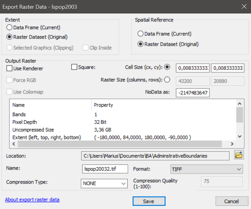

I have Layer (.lyr) file from Oak Ridge National Library Landscape (attached below) which contains data points and a corresponding scale for density. I want to cluster around the Nile River in Sudan in order to see how urbanization and overall population density changed from one specific year to the next.
However, I am unable to convert the layer file to a shape file as it gives me this window when I try to export it:
Do you guys have any idea how I could be able to cluster such a file as in this case?

Hi Marius,
It looks like you have a .lyr file of raster imagery.  You would need to get the raw imagery (i.e. TIF, IMG).  You could then convert this to a polygon or point feature class using the Raster to Polygon or Raster to Point tools.
Once you have a polygon/point feature class, you can execute the Optimized Hot Spot tool.
