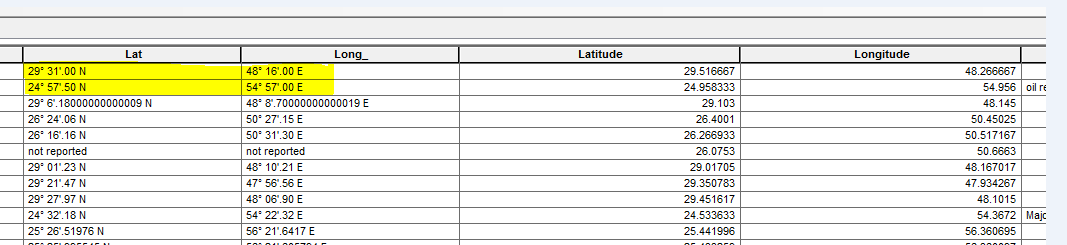

We have table with data as shown in the screen capture below:
Is there way we can use 'field calculator' to populate the values in Degrees and Minutes? I came across following article however this cannot be used with 10.3:

Right click the field heading and select "calculate geometry". You should be able to specify x/y coordinates in decimal degrees.
SepheFox
Deactivated User
...or degrees decimal minutes, or degrees minutes seconds, as you prefer.
