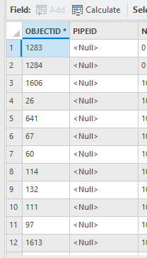

Hello,
Just wondering that could I automatically to create IDs for the existing feature classes?
For example, I have pipes in the database already, the PIPEID fields are all Null, but I do not want to given them the IDs one by one.
How could I do something to create the IDs automatically.

One way to accomplish this would be to write an attribute rule that would run every time a feature is created to give it a unique ID using a sequence. Then what you can do is take that arcade expression and use it in the calculate field tool on this layer (just make sure you set the language to Arcade).

In words, left click on the field header and choose calculate field. The expression type must be Python 3.
In the "Helpers" group type (or scroll to) S and click Sequential Number, then apply. This will automatically give numbers to your items in order.

Thank you for my late reply. I can do what your refer video says. Last question is how to add letters and symbol in front of the sequential number? Like DESR-?
RobertKrisher
I prefer to use the Concatenate arcade method, but there are several other approaches. You can find an approach that outlines a few ways to handle the prefixing and concatenating in this post (also with a video): Generating Unique IDs with Attribute Rules (NextSe... - Esri Community
