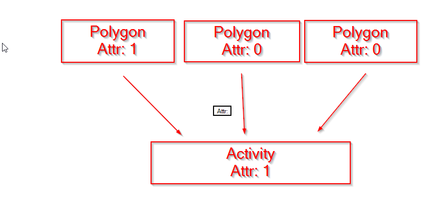

I have a Point Layer and a Polygon layer and I need to attach the Polygon Layer Attributes to the Point layer. However, there may be 3 polygons to one point. Currently, when I join the Polygons to the Points, it just randomly chooses one of the polygons to pull data from. We want to have a little more control on what data is being attached.
We are mostly interested in one of the Fields from the Polygon layer. It is a binary layer basically saying if there is a boundary that was uploaded (Binary). There could be three polygons and they all have different attributes in this field (Ex: 0,0,1) or it could just be one polygon and we are not to worried about it. Our goal is to pull the data from the polygon that has a 1. If it does not have a one, print 0.
I am having a hard time doing this with a Join, not sure if that is the way to approach this. In my head I want to just say, prioritize the join for when this field is = 1. Is there a way I can do this?
I made a visual and I hope it is helpful. TIA! 
