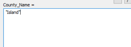

Hi.  I can't seem to figure out how to auto-populate a new field I created in an attribute table.  Using Desktop ArcMap 10.5.  The field I created is text and I want the entire field to be auto-populated with the same County name "Island".  I've tried multiple times using Field Calculator in an Edit session, typing "Island" in the script box or trying the command: Replace ([County], "  ", "Island") but always get a geoprocessing error "Failed to execute. Parameters are not valid." and "ERROR 000732".  Basically, I need to create a new field that specifies the county name which is the same for the entire feature class, and not sure why this seems so challenging...I must be missing something.  Other feature classes I have to do the same thing have over 4,000 point entries, so manual input of this field is not an option.  Any ideas?  -Sarah

Is it a new field you are creating? if so the current values should be Null.
You can use the Field Calculator and without using replace function you can directly try assigning the value.
"Island"
This should allow assigning the text value to all the records.

Hi, thanks Manish and Dan.  I just figured out my error...I had changed the name of my layer in the TOC from the shapefile name, so apparently Field Calculator doesn't like that.  I changed the name of my layer in the TOC to match the shapefile name and Field Calculator worked beautifully.  Thanks again! -Sarah

To calculate strings to text or character fields, on the dialog box, the string must use double quotation marks ("string"), or in scripting, the string using double quotation marks must also be encapsulated in single quotation marks ('"string"').
Many a person has wasted time forgetting, or not seeing, this requirement.
