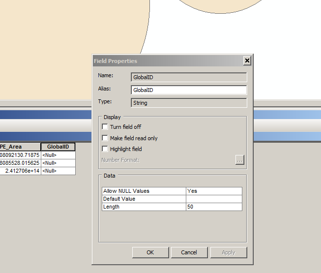

I am wanting to do this as well. Your posted solution does not feel very robust to me because it is based only on the name of the field. I was able to add a GlobalID text field to a fgdb feature class. This would be a false positive in your code. I looked over the field properties for a better solution, but I don't see one. It would be nice to have a function that returns a boolean--something like: hasGlobalID(table/feature class) = True/False.
We want to add global ids to all ersi objects in our database but some have existing global ids.
