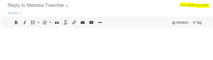

When replying click on Use Advanced Editor at the top right:

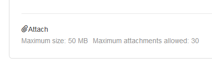

Then you will see the Attach option in the lower left hand corner:

Thanks, I had to reply to original message to see the advanced option.
