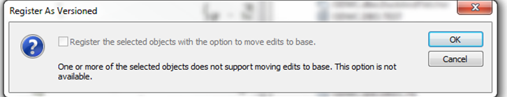

I am trying to fix a feature dataset in our ArcSDE geodatabase which we are currently completely unable to edit. The feature classes within it are a mix of versioned and non-versioned feature classes and the dataset does not participate in a topology or a geometric network. I have tried to register the entire dataset as versioned; however, I get this message when I do:

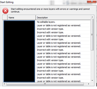

If I select "OK", all of the tables are still not registered as versioned. When I go to edit, each feature class has two errors listed which are "Layer or table is not registered as versioned" and "Incorrect edit version type".

Did you try changing the following option under editing options?
Check the option Edit a version of the database with the ability to undo and redo.Refer to the attachment.
MarianneFarretta
Kara, take a look at this documentation: 38414 - Start editing encountered one or more layers with errors or warnings and cannot continue. In...  You mention your mxd has a mix of versioned and unversioned data layers, which may cause this error in certain circumstances.
