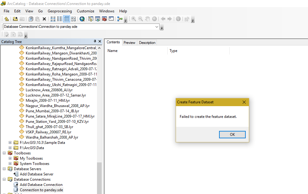

hi all,
i have installed arcgis 10.3 and connected with oracle with a direct connection.
i am able to create feature class and on top of that i am able to perform all  feature class operations.
but while creating a feature dataset it throws a error.and doesnt create feature dataset.
am i missing something in configuration ? !

Hi Vaidhy Panday,
Can you right click on your connection (connection to panday) and paste the screen capture of options available?
Thank you!
VaidhyPanday
Deactivated User
UmakantJoglekar2
Deactivated User
Thank you for the screen capture!
This explains why you cannot create a feature dataset. You are working with an Oracle database with NO geodatabase in it. A feature class is nothing but a table with spatial column in it however feature dataset is a logical geodatabase entity which requires you to have geodatabase enabled in order to create/use feature dataset.
