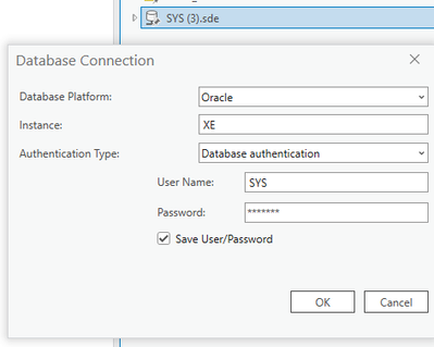

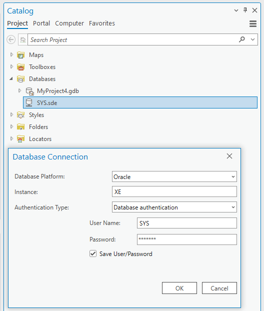

In ArcGIS Pro, I can connect to the Oracle database's SYS user using a database connection in Catalog:

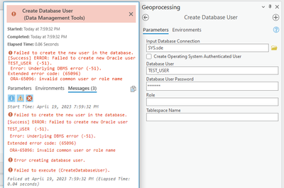

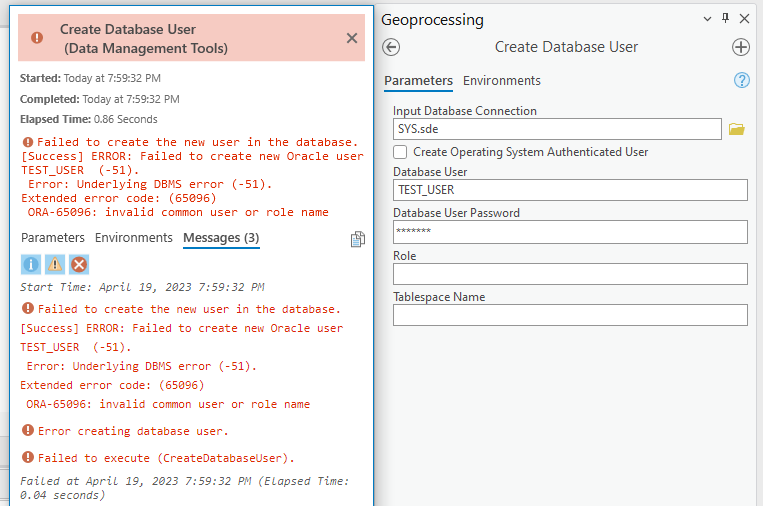

I tried using the Create Database User geoprocessing tool, but I get an error:
Failed to create the new user in the database. [Success] ERROR: Failed to create new Oracle user TEST_USER (-51).
Error: Underlying DBMS error (-51).
Extended error code: (65096)
ORA-65096: invalid common user or role name
Error creating database user.
Failed to execute (CreateDatabaseUser).

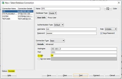

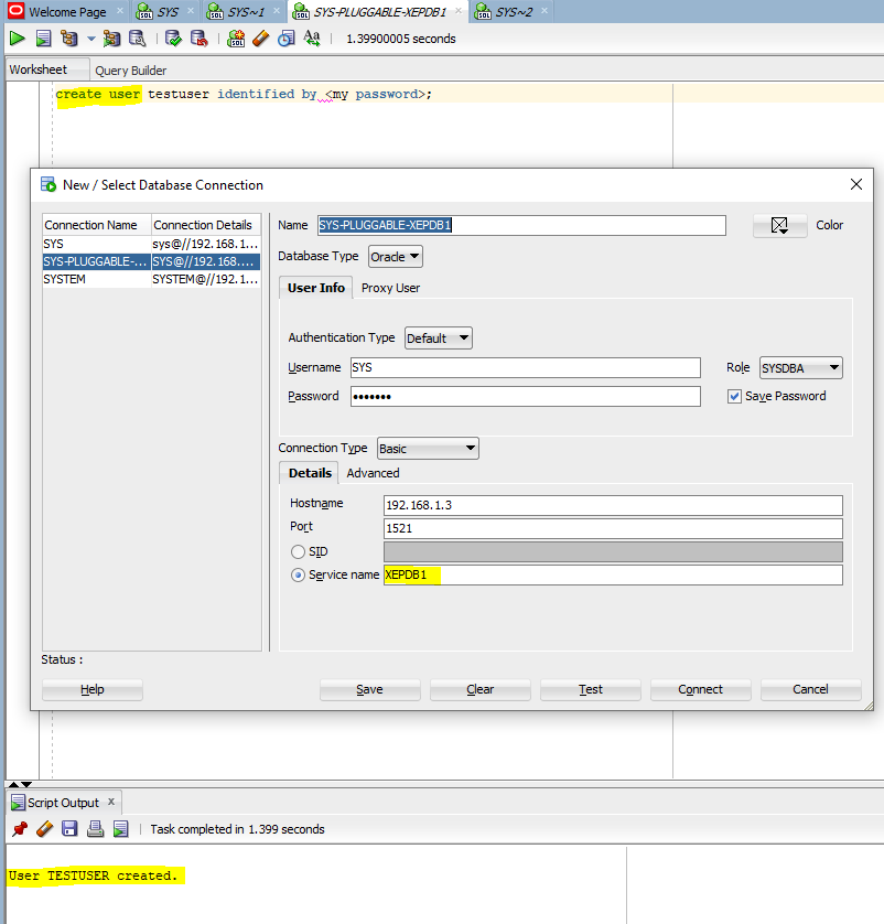

I was able to connect to the XEPDB1 PDB in SQL Developer and create a new user:
But I don't know how to connect to XEPDB1 in ArcGIS Pro.
This is my existing SYS connection, which works as expected. I used Instance=XE (XE is my database name/SID).
But as we mentioned, that connects to the CDB, not the PDB.

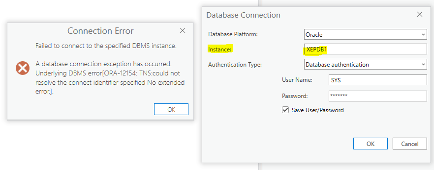

So I tried creating a similar connection, but this time using Instance=XEPDB1. But that didn't work.
Failed to connect tot he specified DBMS instance.
A database connection exception has occurred. Underlying DBMS error[ORA-12152:could not resolve the connect identifier specified No extended error.].
I suspect I got that error because XEPDB1 is a Service Name, not a SID. But I'm just guessing.
How can I connect to the XEPDB1 PDB in a ArcGIS Pro database connection?

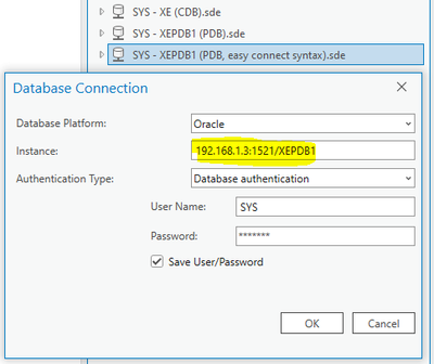

MarceloMarques
ArcGIS Pro use for "Instance" the Oracle easy connect syntax "192.168.1.3:1521/XEPDB1"
You can test this via Oracle SQL Plus first, if able to connect with SQL Plus then ArcGIS Pro will be able as well.

Thanks, just saw this message now.
I tried 192.168.1.3:1521/XEPDB1 as you suggested, and it worked in an ArcGIS Pro database connection:
Although I made that connection after adding XEPDB1 to TNS.
So I'm not sure if XEPDB1 in TNS is needed or not for the easy connect syntax.

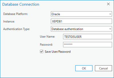

Now, I'm able to connect to XEPDB1 in an ArcGIS Pro database connection (reminder: restart ArcGIS Pro after editing tnsnames.ora):

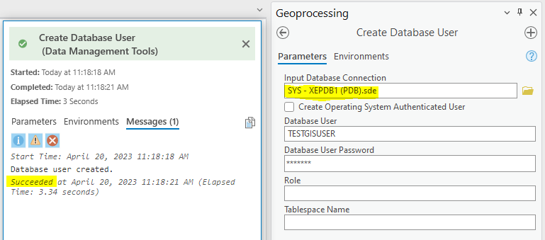

Likewise, I'm now able to create a new user using the Create Database User geoprocessing tool, because I'm connected to the XEPDB1 PDB:
And I can connect to the new user:

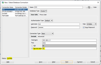

1. If I understand correctly: I didn't need that TNS entry when connecting to XEPDB1 via SQL Developer because SQL  Developer using a different connection mechanism -- JDBC, not the database client (ArcGIS Pro uses the database client).
2. Side note: In SQL Developer, I think I can connect to either the SID (XE) or the Service Name (also XE).
