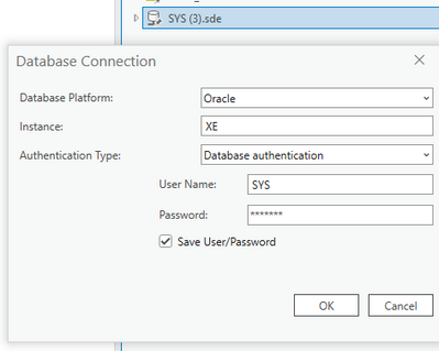

I can create a database connection to a CDB without issue:
However, I don't see a way to create a database connection to a PDB (pluggable) Service Name.

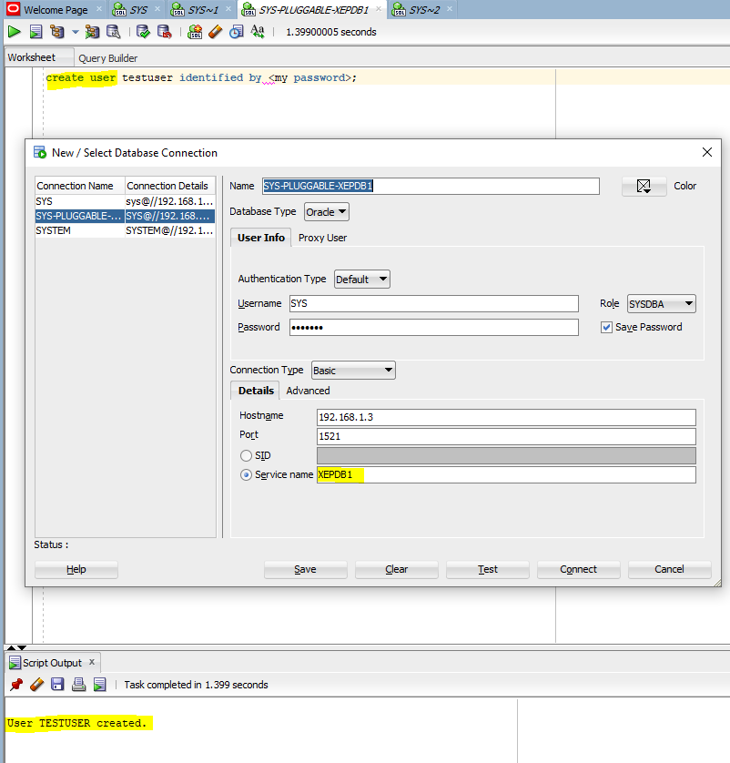

In SQL Developer, a connection to the default PDB (XEPDB1) looks like this:
That connection uses a Service Name instead of an SID. So the connection to XEPDB1 works as expected.

Now, I'm able to connect to XEPDB1 in an ArcGIS Pro database connection:
Create database user in Oracle 18c XE via ArcGIS Pro

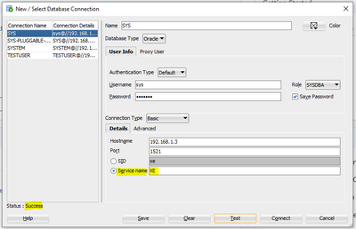

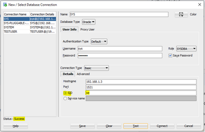

1. If I understand correctly: I didn't need that TNS entry when connecting to XEPDB1 via SQL Developer because SQL  Developer using a different connection mechanism -- JDBC, not the database client (ArcGIS Pro uses the database client).
2. Side note: In SQL Developer, I think I can connect to either the SID (XE) or the Service Name (also XE).
