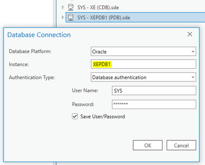

I figured out my problem.
My TNS wasn't set up correctly. I had to add a TNS entry for XEPDB1. (Previously, it only had an entry for XE.)
 XEPDB1 =
  (DESCRIPTION =
    (ADDRESS = (PROTOCOL = TCP)(HOST = 192.168.1.3)(PORT = 1521))
    (CONNECT_DATA =
      (SERVICE_NAME = XEPDB1)
Now, I'm able to connect to XEPDB1 in an ArcGIS Pro database connection (reminder: restart ArcGIS Pro after editing tnsnames.ora):

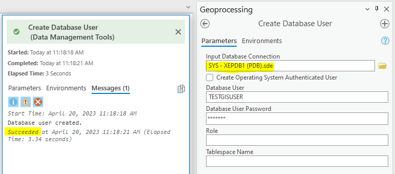

Likewise, I'm now able to create a new user using the Create Database User geoprocessing tool, because I'm connected to the XEPDB1 PDB:
Create database user in Oracle 18c XE via ArcGIS Pro
