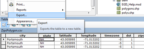

LukeSturtevant
It looks like you are attempting to edit the csv table. Export it to a geodatabase table from the attribute table menu:
Then it will have assigned OIDs and you should be able to edit it.
