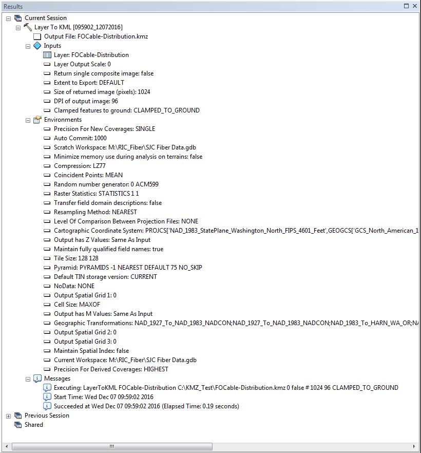

I'm using ArcGIS 10.2.1 desktop and trying to convert a layer to KMZ from inside an MXD.  This process has worked before on multiple occasions.  The layer in question is sourced out of a SQL database on a networked server.  The layer is displaying properly, and the results window shows a successful completion, but no .KMZ is generated.  Here's a screen-grab of the results window showing inputs and environment settings.  What am I missing?

The time lapse for the conversion is very fishy. And the input layer appears as a table versus point/line/polygon. Can you tell us a little about the input feature class?

LauraAnderson1
It's a line FC.  It's a subset of a larger set defined by a simple definition query.  Again, it's worked previously.
