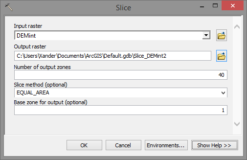

The alternative would be to create a new raster using Slice—Help | ArcGIS for Desktop with EQUAL AREA. This excepts more than 32 classes. If you use 40, you will have 2.5 percentile for each value produced. With 50 zones, each output value represents 2%, etc:

I tried to use Slice and did this into 40 equal area intervals. This worked but the original value (the precipitation value) was lost. However, then I did combined it with the original raster which yielded a raster dataset where all the precipitation values have a number. Then I can use Con("rasterdataset"!=1,"rasterdataset") and Con("rasterdataset"!=40,"rasterdataset") to remove the two 2,5 % tails. Should solve the problem!
Doed this sound reasonable? I dont know if it could be solved it a smarter way, though.

You could use the SetNull tool to set the tails to NoData. However, if the idea is just for visualization, you can better use suggestion Dan provided.
