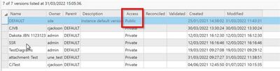

I am trying to figure out how to change the access level of the default version of a branch versioned feature service. The aim is to change the access from public to protected.

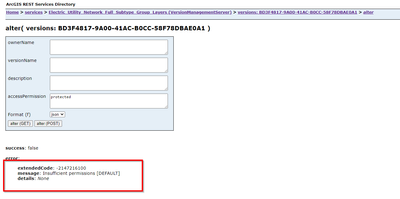

In ArcGIS Pro and via the Version Management service (Alter Version on REST) it is showing that the admin user that owns the service doesn't have the permission to change the access.

The access level of default needs to be altered through a database connection connected as the geodatabase administrator (typically either sde or dbo).

If the DEFAULT version somehow reverted back to public, that could be a bug. However, when altering the DEFAULT version for branch versioning, as previously stated, you need to do this through the database connection. More specifically however, you need to make sure the database connection is using a branch versioning connection (Geodatabase Connection Properties > Branch).

For the record, the answer lies in setting your sde or dbo geodatabase connection to "Branch" when you want to set the DEFAULT (branch) version to "Protected".
Most likely, your direct connection was set to Traditional versioning when you altered the access permissions on Default to "protected" the first time.
