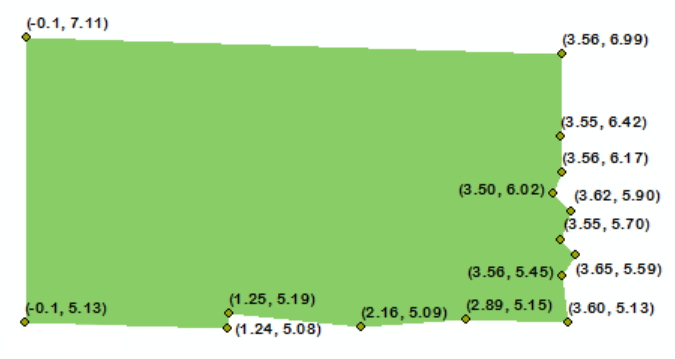

JoshuaBixby
MVP Esteemed Contributor
To illustrate xander_bakker‌'s comment, how many "sides" does the following polygon have?  4, 15, or something in between?
Example of polygon with 4 uneven "sides"
