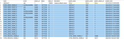

I have already created few read-only offline maps for just read only purpose. When we create a offline maps, it does create replications in geodatabase. when users download the offline maps from devices, it does create a replica and few orphaned records got inserted in sde.sde_versions  table. the records are not being deleted even though we unregistered the replicas and deleted offline maps from the devices. in order to compress the database, we should delete orphaned records and unregister the replicas. I have already written a python job to automate this process.  I am able to unregister the replicas successfully without any issue, the problem is with deleting records from sde_versions table,
sde_conn = arcpy.ArcSDESQLExecute(gdb_conn)
sql_query = "DELETE FROM sde.sde_versions WHERE name LIKE 'SYNC_%'"
sde_conn.execute(sql_query)
even though the statement executed successfully, the records are still exists in the table. Please suggest on this to proceed further.

I tried delete version tool to remove the orphaned versions . It did not delete the orphaned records . It deletes only visible versions not hidden ones . I have no clue on this . I have been deleting records from sde_versions as suggested by esri technical team using delete sql statement using sql server .  now , I decided to automate the process

When i see in SQL Server sde_versions table ,
at the same time, I logged in as a SA user,
I could not see any versions

If you logged as SA user, then this is the SQL Server Instance System Administrator, the SQL Server Geodatabase is not designed to work with the SA user.
You must use ArcGIS to connect to the SQL Server Geodatabase using the SDE user, the owner of the ArcSDE Repository, which will be able to see all the versions and delete any versions, if you connect with the data owner user, then you will still see all versions but the data owner user will be able to delete only the versions that the data owner user created.
You will not be able to delete a version if there are other users connected that might be using that version, hence make sure you disconnect all users and stop all ArcGIS Server services, then you can perform the unregister replica, and delete the versions associated with the replica, but you need to connect with the SDE user.
