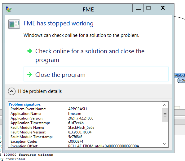

Here's the scenerio.  I have Three tables in an Oracle database that I am combining using FME.  I then am using An SDE Writer to write to a different Oracle database (the oracle writer put the data in a format that I cannot use with Enterprise 10.9.1, so I chose the SDE writer instead).
There are close to 700k features that need to be written, but the FME crashes and the program closes after writing about 160k features EVERY.SINGLE.TIME.
Things I've tried:
  • Redirected the output to the data inspector.  The work flow completes without errors.
  • Added a geometry validator and repaired bad geometries and ignored those that couldn't be repaired (none).
  • Added a feature keeper to collect all the features and write them after join is complete (all ~700k features are collected, still crashes in the writing phase).
  • Set the writer to ignore all invalid features and continue.
  • Successfully wrote ALL features to a file GDB.
There is no error message in the FME, but a general error message pops up (shown below) which ChatGPT says is a "heap corruption error" and I have no idea how to fix it.  Any suggestions?

It's FME that's crashing, but ONLY when using Esri ArcSDE writer.  I can write to a file geodatabase using the Esri geodatabase writer with no issues.  I tried writing to that then reading from the GDB and writing to the SDE.  Still the same issue.  It's clearly a problem that exists only with the SDE Writer (AGOL writer works fine, GDB writer works fine).

The EsriProjector transformer was used to project the coordinates to ESPG:3857, then I chose ESPG:3857 on the SDE writer.  When I do this, it writes 167k parcels and crashes.  If I choose a different coordinate system on the writer (Say ESPG:4326) it writes ALL 658,315 features, but puts them in the ocean.
Weird thing is it crashes when I choose the correct coordinate system, but works fine when it's not the right coordinate system.
