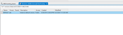

Although, I Connected with sde user , could not see those SYNC versions

You will not see any SYNC versions using Pro GUI. These versions will not show. Expected behavior.
As Marcelo stated, these versions should not be deleted until further investigation and confirmed that they can be deleted. Prior to deletion of any of these SYNC versions, take a backup. These version will not appear in drop down using Delete Version GP tool, but the name can be typed in and will be deleted if conducted by the version owner.
