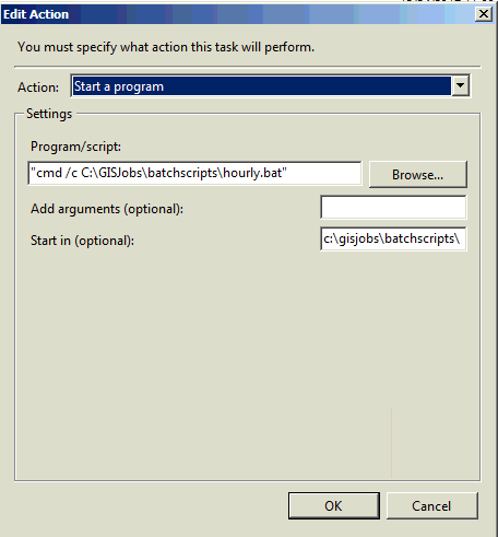

Will do Ken.  My issue isn't the scheduled task, but I have had issues with that in the past.  The scheduled task would run - the .bat file would run, but the Python script within the .bat file didn't.  The solution we came up with was in the Actions tab - you have to put the full path to the .py script in the 'Star in (optional):' dialog - even if it is in the .bat file path or elsewhere.  We also quoted the program, script.  See screen shot attached.  Once we did this - the python script began running again.  We used to not have to do this, but something changed (windows update?) and we had to debug.  Not sure if this will help you or not, but might be worth a try.
Darryl
