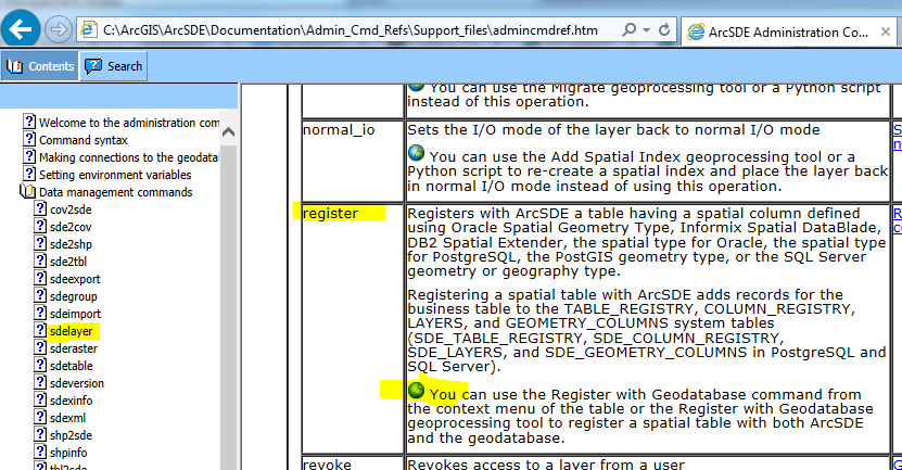

Vince, the admincmdref documentation for 'sdelayer -o register' states:
  • You can use the Register with Geodatabase command from the context menu of the table or the Register with Geodatabase geoprocessing tool to register a spatial table with both ArcSDE and the geodatabase.

I pulled the quote from the admincmdref directly from the document that gets installed with the ArcSDE command line tools 10.2.2 installer at %installdir%\ArcSDE\Documentation\Admin_Cmd_Refs\Support_files\admincmdref.htm.  If this is indeed a loophole, then it's still there at the current release.  Look in Data management commands --> sdelayer:
Yes, it does say 'table' in this documentation, but if using this command is not exactly what Vince Angelo said to do, then I'm terribly confused.
