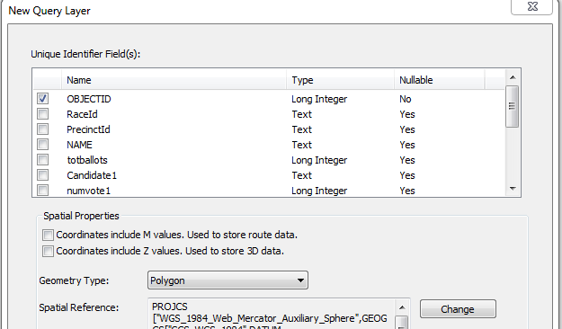

I have to say that ESRI has been most unhelpful in providing info on what's coming up at 10.3 - just look at the number of threads there are on this topic!!  Your users rely on the type of spatial views that command line provided, and there is no combination of GP tools that allow you to create an "sde-registered" view.  Anyone who says using query layers in place of spatial views is an option seriously needs to go through this dialog when adding 30+ views to an mxd - you'll understand our pain:

For your comment about the database views prompting for the unique identifier field - there is an existing bug for this and we are aware of this issue. I would suggest that you contact support and ask to be added to this bug since there is only the workaround of using the commandline tools to create the view or saving out as a layer file.
NIM085661 - ArcGIS does not set the first not-null field it finds as the unique identifier for a database view.
